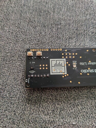

Here are 2 of my respeakers, where I soldered the included GPIO header on it.
