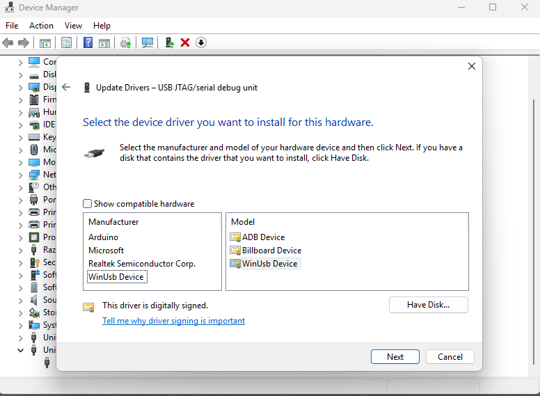

The following steps may be helpful.
  1. Is “USB JTAG/serial debug unit” listed under “Universal Serial Bus Devices” in the Device Manager?
    Note: not “Ports (COM & LPT)”.
  2. If not, this method does not work.
  3. If so, right click “USB JTAG/serial debug unit” and “Update Driver”
  4. select “Browse my computer for drivers”
  5. select “Let me pick from a list of available drivers on my computer”
  6. select “USB Serial Device” and click “Next”
If you are lucky, it will be restored.

Thanks for your response,
The device is listed under Universal Serial Bus devices, But i don’t seem to have the USB Serial Device Driver you mentioned
Thank you

Turn off the check mark and pick USB, as @msfujino indicated.
Hello,
I’ve unchecked the show compatible hardware checkbox i’m still unable to find the USB driver,
I’ve checked through the options, Perhaps the correct driver is not installed?
