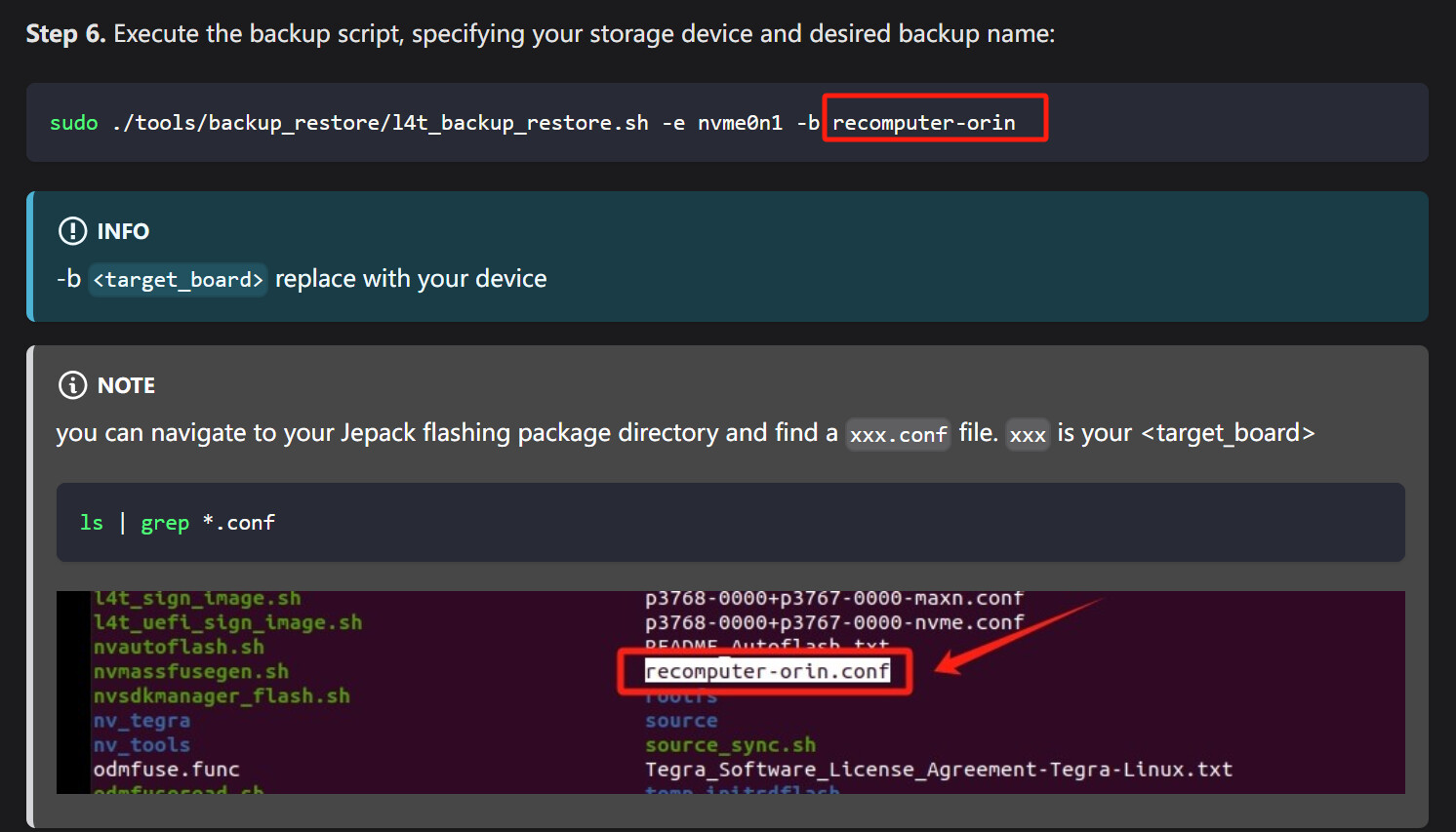

I’m currently trying to create a backup of a reComputer Industrial running Jetpack 5.1.1 in order to set up a number of other devices identically. I’m following the instructions provided here:
After downloading both the Jetpack 5.1.1 image for the J4011 and the BSP for L4T 35.3.1 and copying the files across, I get the following error when trying to run the backup script:
> sudo ./tools/backup_restore/l4t_backup_restore.sh -e nvme0n1 -b recomputer-orin
[sudo] password for user:
./tools/backup_restore/l4t_backup_restore.sh: illegal option -- e
Usage: l4t_backup_restore.sh -b [ -c ] <board-name>
       l4t_backup_restore.sh -r <board-name>
	This script creates a backup image of a Jetson device or restores a Jetson device using a backup image.
	This script should be run inside initramfs.
	Options:
		<board-name>                 Indicate which board to use.
		-u <PKC key file>            PKC key used for odm fused board.
		-v <SBK key file>            SBK key used for encryptions
		-h | --help : Display this message
		-b : Generate the backup image and store it in /home/user/seeed-flash/mfi_recomputer-orin-industrial/tools/backup_restore/images
		-r : Restore the backup image from /home/user/seeed-flash/mfi_recomputer-orin-industrial/tools/backup_restore/images
		--raw-image ---------------- Specify the path of the raw disk image to be restored into storage devce.

Please check if the parameters you used when executing the script are correct. The parameter after “-b” refers to your device. Please replace it with your current device.
Thanks for your reply, sorry - missed that step, I’m now using the correct device name, however getting the same error.
sudo ./tools/backup_restore/l4t_backup_restore.sh -e nvme0n1 -b recomputer-orin-industrial
