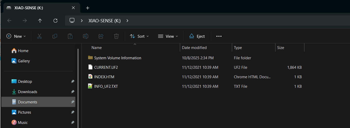

Nrf_connect WON’T recognize it past the programmer because there isn’t any MCUBoot partition on a stock XIAO. :v: (nugget)
The xiao nrf52840 can be recovered with a double-reset press + erase the current.u2f file that appears on the mass storage drive that shows up when you double reset.
I discovered this by accident =D
it’s got to be a quick double press, triple press will put it back to running the bad code.

Not super fast, I just got one out of the box (nrf52840 sense) and got it to go into MSD mode with one try, using about the same speed as windows expects for a double click.
Then i get this:
if i delete CURRENT.UF2 and reset, it clears when I’ve bricked it in the past.

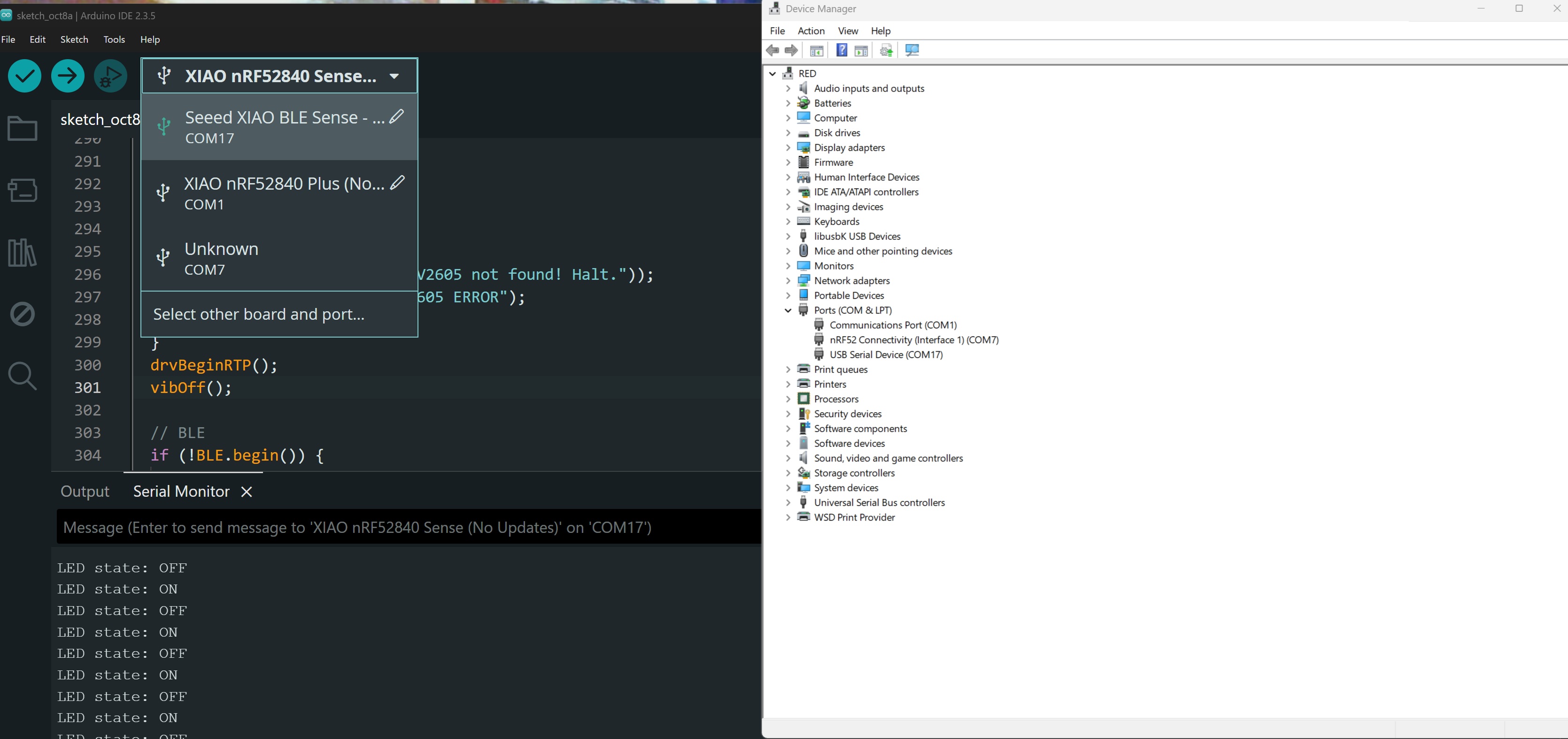

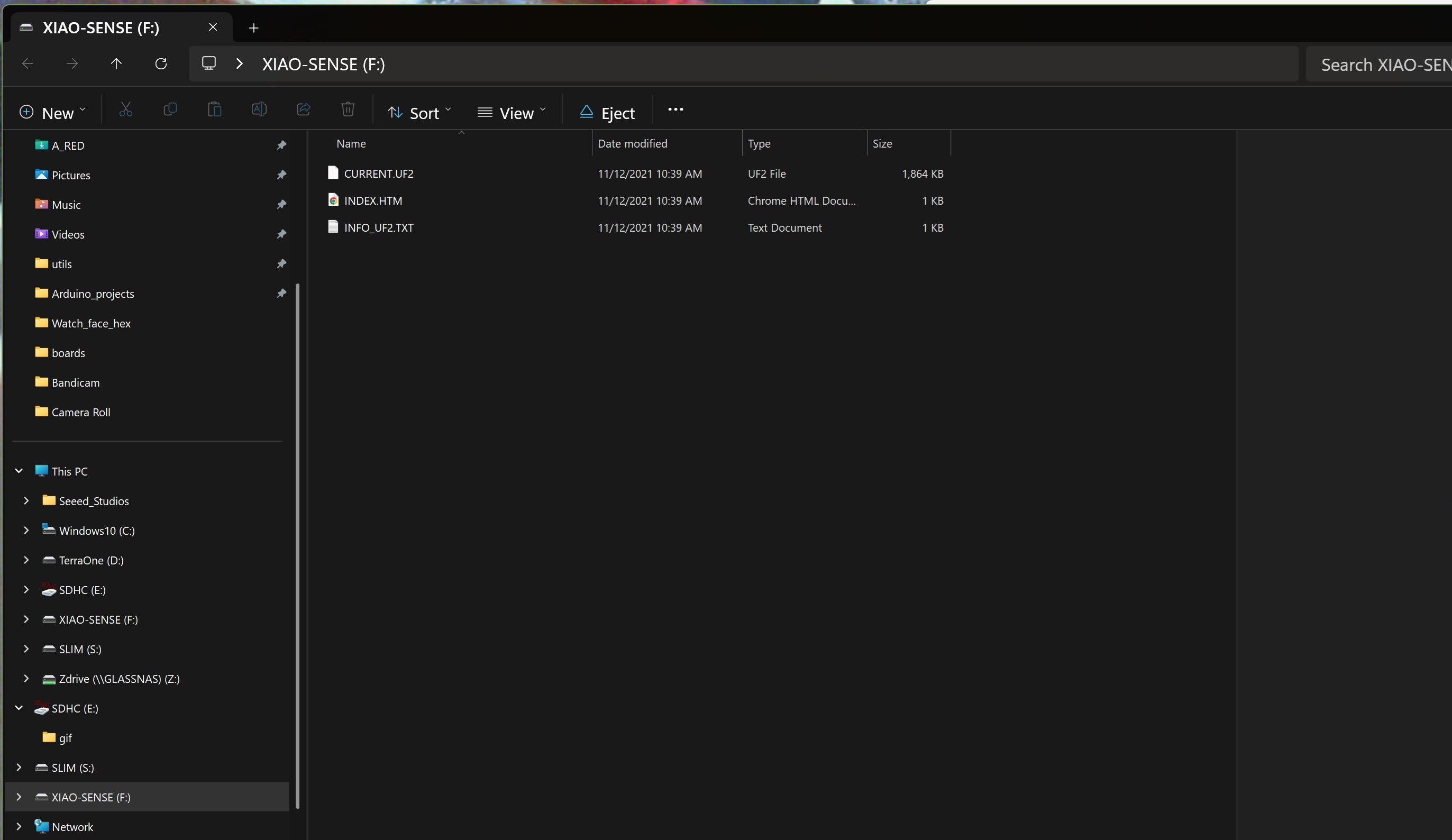

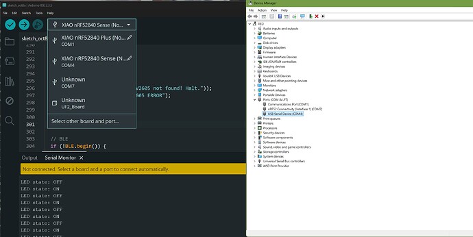

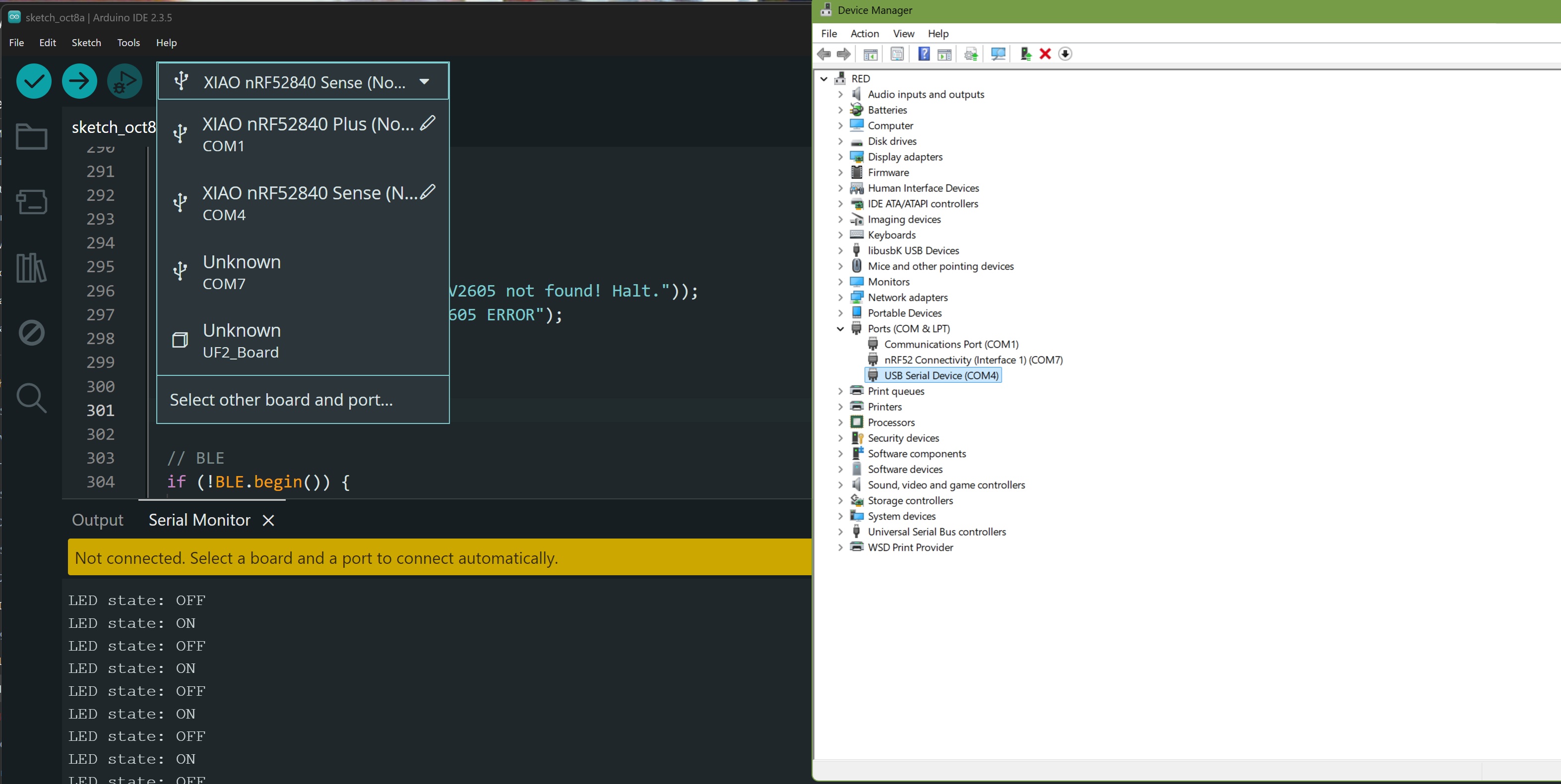

SO I’ll offer here is the Normal scenario for me with some check points, how does yours size up ?
Normal mode, Xiao plugged in Windows et’al sees it as Com4
BootLoader mode (reset and double/triple presses)
UF2 drive pops up.
and a rushed , Rough , very rough Video of said processes filmed on a Potato :grin: but should convey the Basic’s
GL :slight_smile: PJ :crossed_fingers:

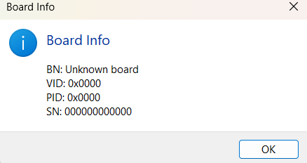

What I see is, VID and PID is set to 0000/0000 for both devices I purchased. This is strange as this is invalid imo.
Whatever I try, the devices (both) only gets shown as COM4 port. There are no additional ports like in video. The port number does not change if I single, double or tripple press reset button.

I hear the frustration and can totally understand, I’m surprised the vid & Pid are all Zero’s too… that is a new one. You gave it everything so it is perplexing to say the least. :thinking:
A return may be in order , tell them we worked with you on the support forum to grease the slide and get replacements.
Before you send them, try a different physical USB port on your computer please, then if at all possible another machine.
after a fresh reboot what does the Device manager say in the Drivers tab. I’m afraid without a Vid or Pid windows won’t know what to enumerate to.
