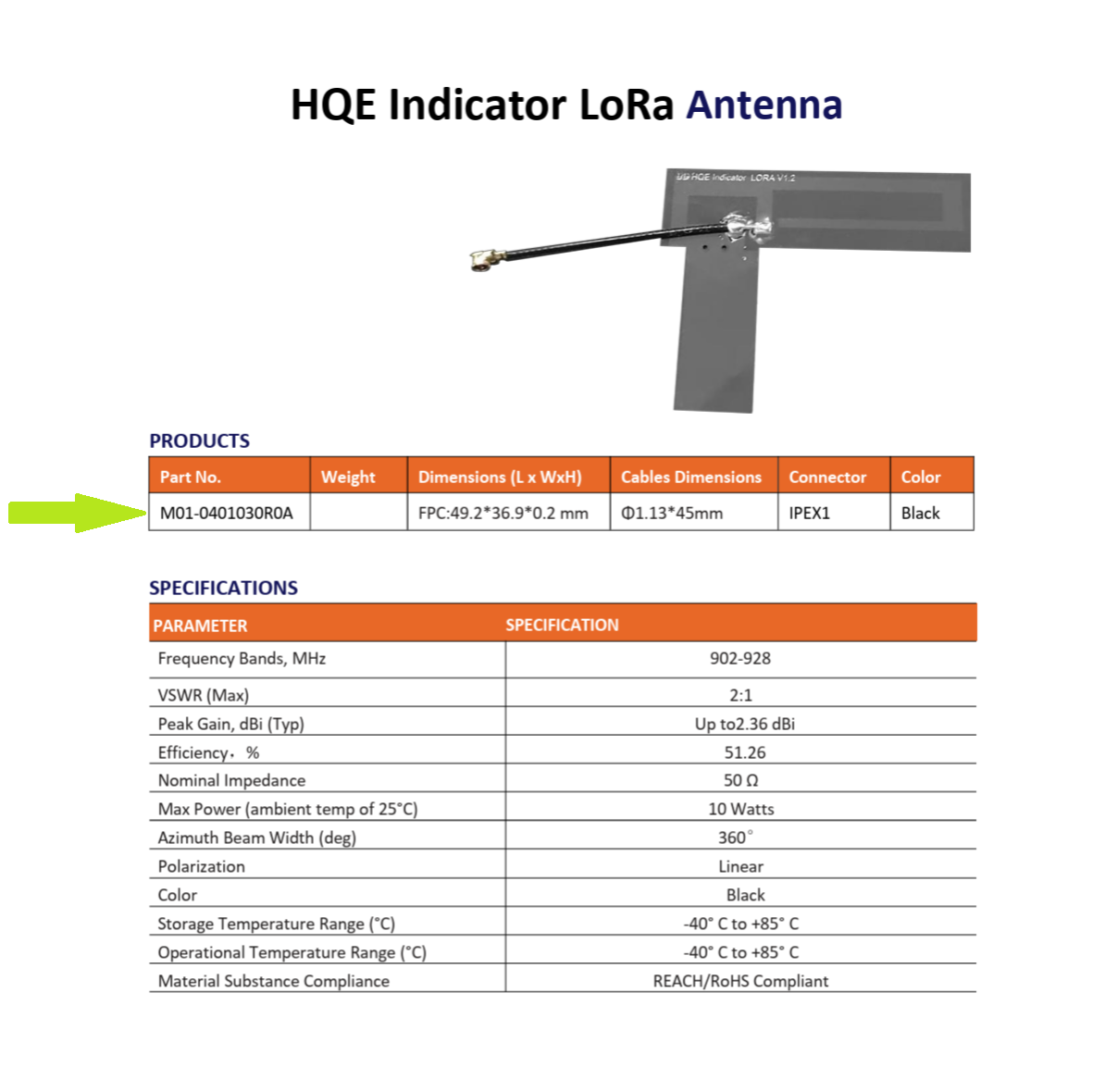

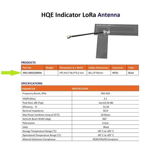

SO , is there a specific reason? the test document says all the specs were performed using the Highest gain ant ? the 8.9db or something?

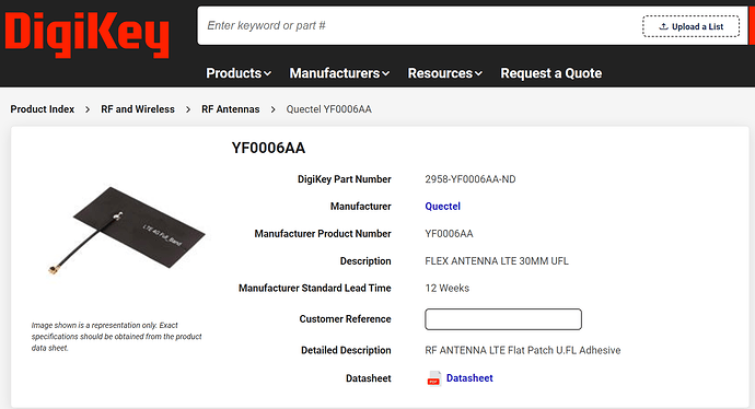

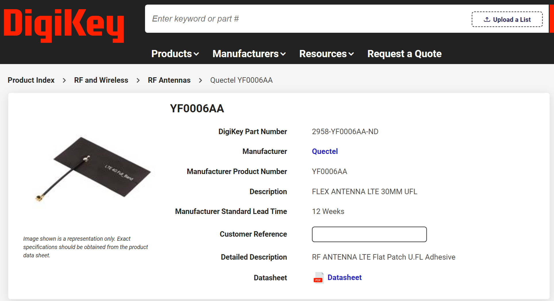

I see this is close from digikey…
50Ohm, 10watts, 2.6db, 928mhz FPC
